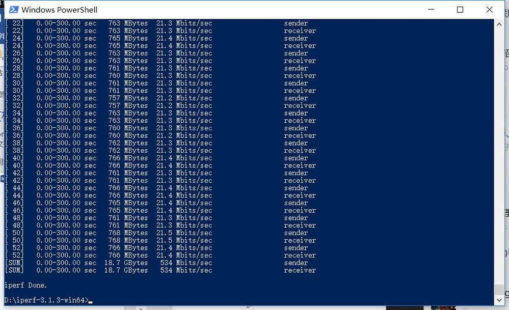

So then I tried a upload test with multiple threads and the result is interesting:
So it appears to be a bottleneck within windows? Where the speed of each thread is limited to 200?

Additional test with ipref's own multithread
I am convinced that the problem is with windows, WAC510 is fine LOL. But do you have any suggestions to correct it?

So for iperf3, -P option must be used to pump more data on parallel streams(-P 10 would utilize full bandwidth of WAC510, -S 0x08 could also be used to maximize throughput using iperf3, More details at https://iperf.fr/iperf-doc.php). Your results are comparable.
I'm not sure about windows bottleneck, If you still want better results with your 'LAN Speed Test' tool, Try running more instances of it(if it supports).
