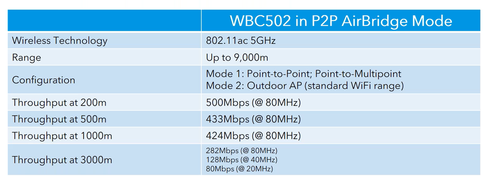

Another thought is the Netgear Airbridge is supposed to be pretty solid when using line of sight. I've never tested on ( BretD ChristineT :) ) so I can't speak from any personal experience but a drop from 500mbps to 150mbps is quite significant. Is there anything in the way or how far are you broadcasting?

again, I've never used the WBC502 but supposedly its rated to 500mbps at 500ft with clear line of site and lined up properly. It'd be fun to test one to see what the actual numbers are. I did ask in a Q&A about actual usage but didn't get a clear answer on speed drop off with distance. And I haven't seen any actual tested data/reviews on one so I can't tell you what an appropriate drop off is.

so at 500ft, there shouldn't be that much of a drop for the airbridge.
