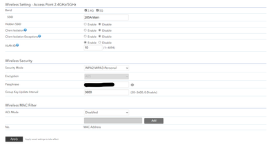

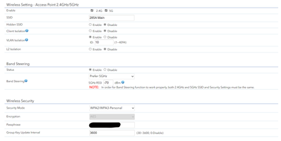

    • jamesstoner's avatar
      jamesstoner
      Star
      Hi, Kurt.
      I can confirm all security settings are the same on both APs.
      Please see images below:
      AP 214
      AP214v2
      The passphrase's are identical but not shown due to obvious reasons.
      Is there anything else I have missed?
      Thank you,
      James Stoner
