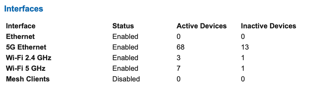

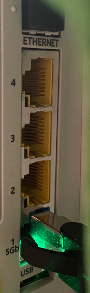

      As far as the AT&T provide modem/router, yes, the 5G ethernet is enabled as you can see below.
      Also, the MS108EUP is plugged into that port as shown with the picture and with the 68 active devices showing up in the interface picture.

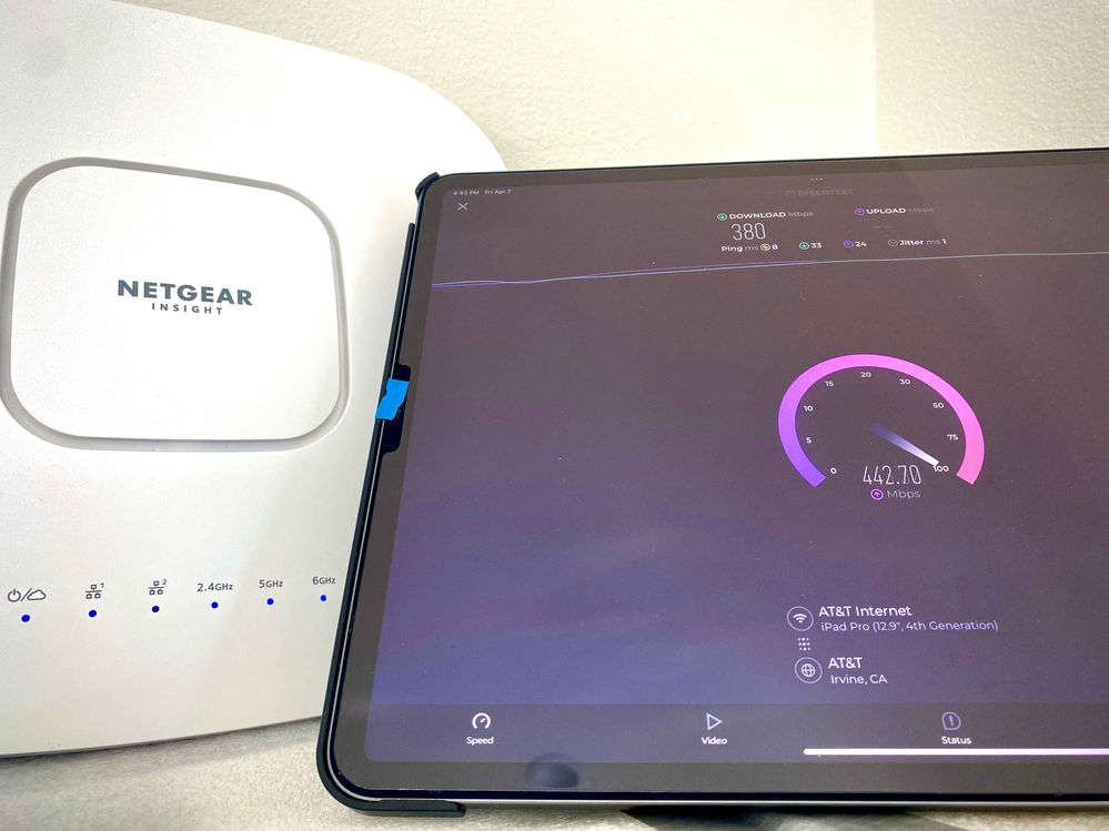

      Also, as you can see, I am in front of my WAX630E with my iPad Pro getting Speedtest.net results just a couple of minutes ago.

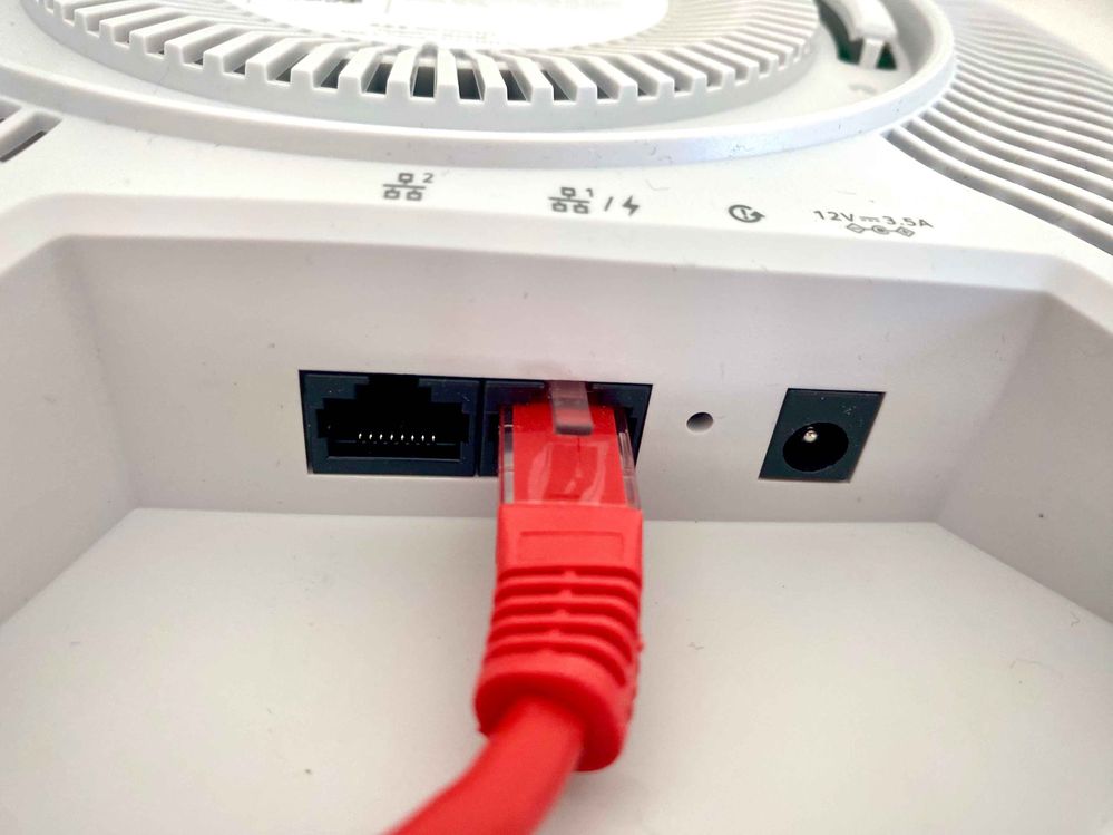

      And this is the back of the WAX630E WAP with the cat6 regular cable attached to the 2.5gb POE port which is attached to the MS108EUP 2.5gb POE++ port 1.
