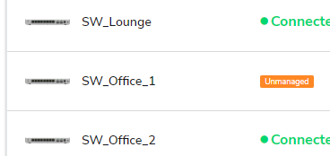

Several WAC540 showing as "unmanaged" in insight
Hello,
We have a lot of devices and some of them (WAC540 apparently) are no longer showing as "connected" in insight.

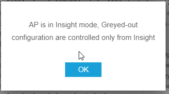

When I log onto the device it still says "insight mode"

  • Ditto - same symptoms have just started here for me too.
    This time a GC110P switch.
    Shows as "unmanaged" even though the switch locally clearly says it's Insight managed.
    Can be rebooted from the Insight interface, but that's about it. Can't access any other settings.

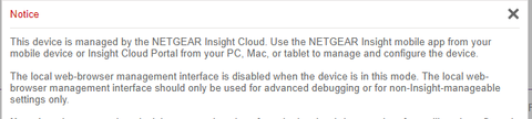

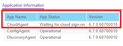

    I noticed this in the local browser interface:
    Given the common timing I'm guessing it's a problem on the Netgear Insight platform end. I haven't changed anything at all on my end and power cycling hasn't made a difference.
