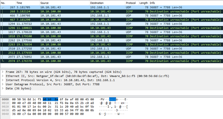

WAC510 sends packets to Port UDP 7788
Hi comminuty,
just discovered that my WAC510s are sending to 192.168.1.1:7788 UDP via eth0.
Port 7788 is not authorized to be used by IANA.
Can anyone please clarify?
Firmware V4.0.7....

Hi DaneA,
have upgraded to latest firmware and performed a factory reset afterwards, then configured only neccesary settings (IP, password).
While no SSID is configured (or Day Zero configured one) no packets (7788/udp) are send out over eth0.
Packets are only sent when there is a configured SSID and clients are connected.
Will try some SSID-specific settings, but this config is used so far (default settings omitted):
IP LAN static (IP, Subnet, Gateway, DNS1+2)
NTP client=on, custom NTP server by hostname (and it is reachable)
Management mode=local (standalone)
UPnP=off
SSID "Guest":
Client Isolation=on
Band Steering=on
VLAN ID=99
802.11w (PMF)=on
One more thing: device is trying to query public NTP servers regardless of setting "use custom NTP server".
Best regards.

- star0815Jun 05, 2018Aspirant
After some tests it looks like udp/7788 packets are only sent when there are two SSIDs configured. After removing second SSID there are no more packets in pcap. Also tried to have different configurations of first/second SSID.
So the config I just sent might not reproduce that behavior, just add a second SSID.
I have also seen my custom NTP server is not responding to device, so querying other NTP servers should be OK despite "use custom NTP server" is checked?
Thanks a lot!
Edit: Just verified, when adding a second SSID (all default values) it starts to send udp/7788 packets.
