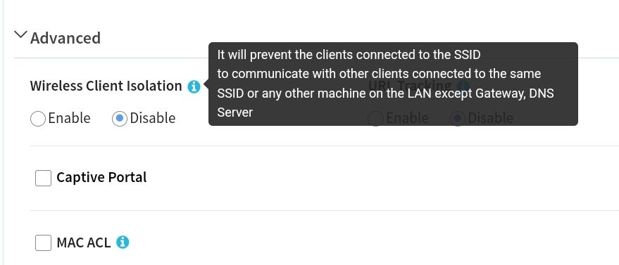

WAC510 Wireless Client Isolation does not isolate client from LAN
Hi, How can I create a guess network where clients are isoated from my machines on the LAN? We have few WAC510's installled and tried to create a guess network by configuring SSID2 as "Guess"...

- FriesLover22Sep 30, 2022Aspirant
To clarify: below is the option I want it to work, but after enabling clients still can connect to clients on LAN
