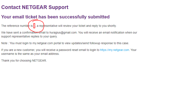

        I have made ticket. This is a second ticket to them I made in last 2 weeks and same situation.
        there is no refference number. First ticket is not answered till now so this one probably will be treated in same way.
        Firts ticket was about scanner. Scanner is not critical for me but random resets seams to be...
