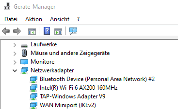

      Click on the search icon, type, and select Device Manager.
      Select the Network adapters option.
      no worries, this is a screenshot from a German Windows 10 system. Very similar on any language:
