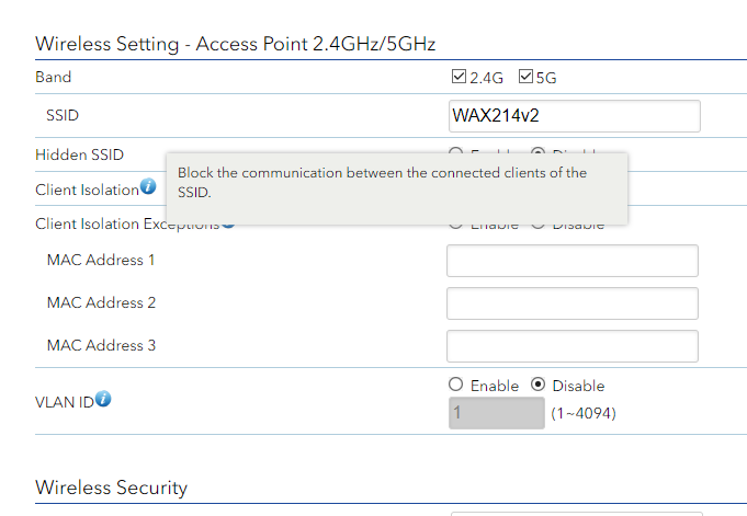

Translating this rant to laymen terms. Under some unknown conditions, it appears the controls for Client Isolation and the related Client Isolation Exceptions remain invisible. The Client Isolation does however work as designed if enabled. Guest devices (locally NATed from a private IP subnet - different from the classic wax214/218 design) will not be able to reach the local LAN subnet eg. like the ubiquitous 192.168.1.1 or 192.168.0.1 of many consumer routers in use behind the guest network.

L2 isolation feature exists on the WAX214v2, v1.0.2.2 or WAX220, v1.0.3.0 similar to the screenshot above), and works in my testing as expected. Not that I'm a Netgear voice or carrying such a hat. The real issue here seems to be the two controls are hidden in the Web browser under some conditions unknown to me.

The WAX220's Client Isolation is working fine... the L2 Isolation is not, nor is even visible. I can absolutely connect to 192.168.1.1 with a Client connected to the Guest Network on the 220, but not the 214v1. Just tried it again as I posted this.
The original firmware for the WAX220 has the L2 Isolation option visible, but updating it to any other version removes it. Reverting back to the earliest version of the firmware posted on the Downloads page does not restore that option.

The last reply before I stop this thread: The L2 Isolation feature as known from the WAX214/218 ...
L2 Isolation
To prevent WiFi and LAN clients on the same access point from communicating with
each other, select the Enable radio button. By default, this option is disabled. If you
enable L2 isolation, clients can still communicate with each other over the Internet.
If you enable L2 isolation, to exclude a device from L2 isolation, enter the MAC address
of the device in a Whitelist field. You can exclude up to three devices....is not available on the WAX214v2 or WAX220.
The default config listed (the only place the feature is mentioned) does show the L2 Isolation Disabled.
Client Isolation
To prevent WiFi clients that are associated with the same or different WiFi networks
on the access point from communicating with each other, select the Enable radio
button. By default, this option is disabled. If you enable client isolation, WiFi clients
Note: If L2 isolation is enabled, the Client Isolation radio buttons are disabledIt's not about Netgear having the L2 Isolation implemented right or wrong.
Would be nice to hear from Netgear team about this missing functionality to avoid similar future disappointing customer communication. DavidGo
