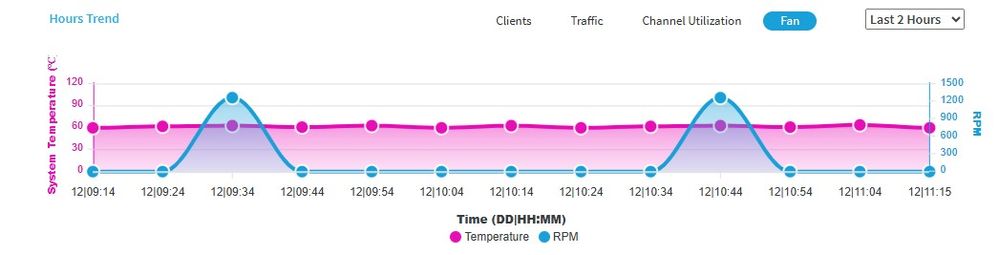

Just installed two WBE710, managed via Insight.
If I log into the device itself, the Dashboard shows an "Hours Trend" chart with a tab to display "Fan". On that screen it shows the device Temperature and Fan Speed.
How do I access this info via Insight? Or is this not an option?

The fan seems to come on at just random times as shown and always for about 20 seconds.
The temp is pretty constant 61-62 degrees; like you mentioned, there doesn't appear to be an exact trigger to kick the fan on. Looking back a few days there were times when the temp hit 63 and 64 degrees with no fan activity. Will have to keep an eye on it this summer when the ambient temp in that location will probably be 10-15 degrees warmer. Place a little silicone mat between the ceiling and the bracket.
This was for the AP upstairs at the top of the stairs on the ceiling; probably the warmest spot in the house. I then checked the AP in the basement (there is no AP on the main floor as I seem to have good coverage as is). The basement is probably 5-10 degrees cooler and looking back over 48 hours the temp was 60-62 degrees with a few hitting 63 degrees. I would have expected a lower temp considering the cooler ambient temp. Interesting....no fan activity at all.
The software engineer in me says to swap the APs and check in a few days to see what happens. But as everything finally seems stable and working, don't mess with it. I'm glad I didn't go with the WEB750 as I'm sure they run hotter. From a business standpoint, still not hot enough to worry about. But from a homeowners standpoint, its my home!
