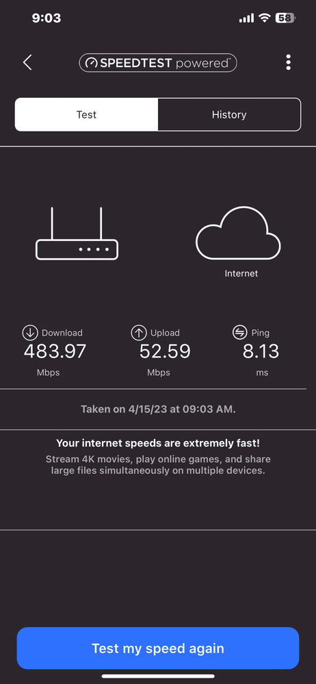

        I'm seeing this on my iPhone 12 Pro Max with the NH app:
        Was told this was max we'll see thru the NH app. Wired speeds with a ethernet connected PC gets me near my 900Mpbs and to spec 50Mpbs on the up though. I have a RAXE500 in wireless bridge mode connected to the 5Ghz radio on the CAX30. I see to spec speeds thru it as well.
