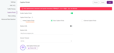

Failed to Activate Captive Portal in Netgear Insight
I am setting a WiFi network with organization-wide SSID enabled.
When I try to enable the Captive Portal, an error message "Only alphanumeric characters and special characters !"#$%&'()*+,-.\/:;<=>?@[]^_`{|}~ are allowed", no matter what characters I input in the Redirect URL field.
I have tried to input "http://www.netgear.com" with the same error message display. May I enquire if I have set anything wrongly?

    • Sololion's avatar
      Sololion
      Many thanks for all the suggestions.
      I have set another SSID for using the basic captive portal, and the same error message comes out.
      No special characters were used in the SSID.
      I have also attached the screen shot in this post.
