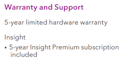

    This system appears to bundle a 5-year subscription to Insight support.  It would be interesting to hear what Netgear support says about this issue. From the Product Data Sheetpage 3:
