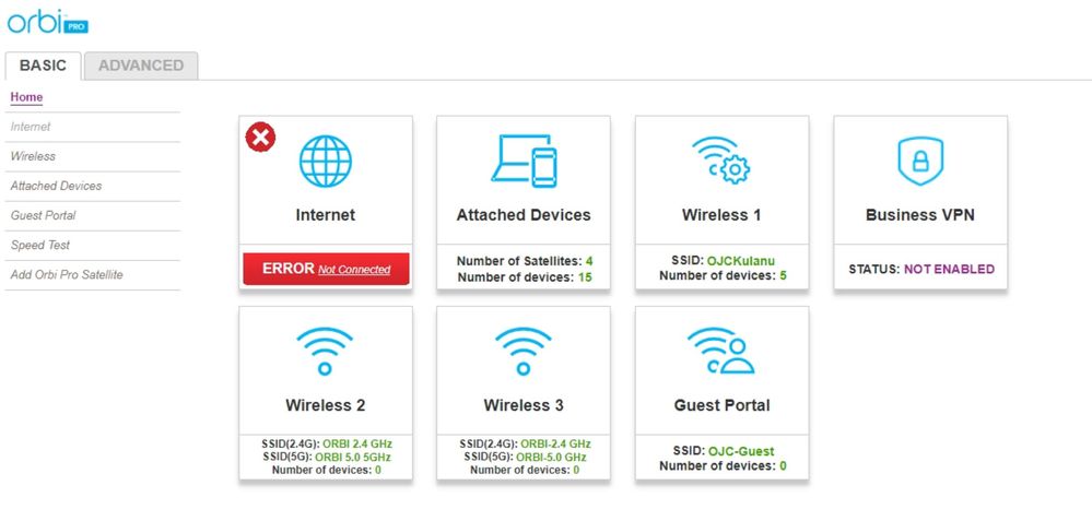

Orbi pro SRR60 Displays Error in Red below the Internet connection in AP Mode
Please let me know how to correct the situation. Router works in AP but displays the Red Error. Thanks.

    do you have your Internet connection connected to the wan port on the router? Or the lan port?
    What router is it connected to?
    • JeffFerg's avatar
      JeffFerg
      Guide
      Thanks for your reply. Yes, the feed from one of the SonicWALL router's LAN ports goes to the WAN port of the Orbi SRR60 in the AP mode. Even though the Internet connection displays the BIG RED sign of "ERROR",  the Orbi in the AP mode provides correct connectivity to devices connected via Wi-Fi. I have connected another SRR60 Pro as a test and it also shows the "Big Red Error" and it also works. Furthermore, I have tested the setup with an Asus, TP and D-Link routers in AP mode, all of them show the Internet connection correctly, not in Red.
      Is there some Error in the Orbi SRR60 Pro Firmware or configuration?
      Thanks,
      • plemans's avatar
        plemans
        wonder if its something in the sonic wall that blocks how the router is checking its internet connection.
