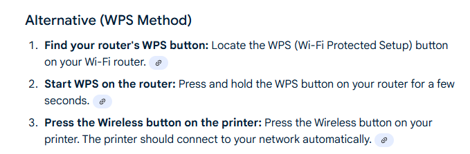

    Thanks for the answers.  Assuming these printers are connected to the Nighthawk with WiFi, many printers can use a WPS button to connect to WiFi.  What are the model numbers of the HP and Canon printers?  (so I can look up the User Manual to see if they support WPS)

    Thanks for the model numbers.  The HP M140 appears to support WPS connection to WiFi:
