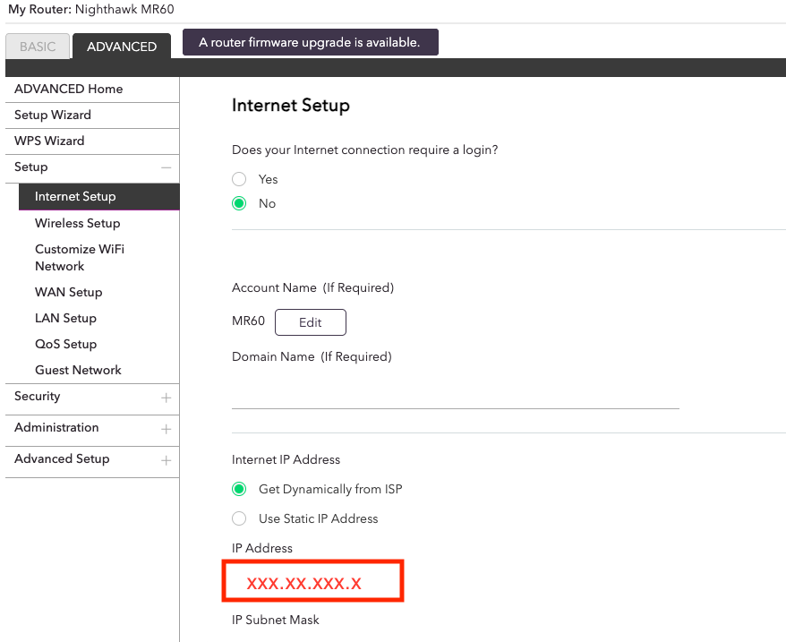

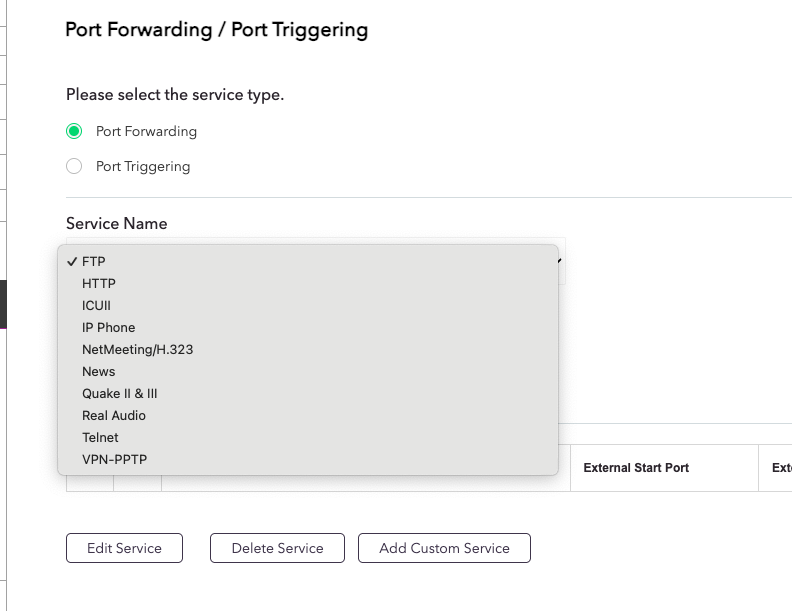

  • Hi CrimpOn​
    Is Telnet considered the SSH in Port Forwarding?
    Also you said
    • Ensure that the MR60 has a public IP address.  i.e. it is not "hidden" behind an ISP router.
    Where do I check that?
    Thanks,
    Mustafa
    • FURRYe38's avatar
      No.
      On the MRs web page in a web browser you can find the IP address given to the MR by the ISP modem on the Advanced Tab page in the Internet section. The IP address will be dislayed on the page here. If you have the nighthawk app you can see the IP address as well on the Settings/Router settings page in the app there.
      • acayci's avatar
        acayci
        Tutor
        Hi FURRYe38​
        Is this the page?  Yes I see a IP address right under the Use Static IP Address radio button.
        It is Nokia.  I believe it is XGS-PON.
        Mustafa
