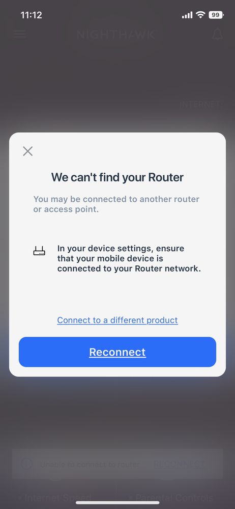

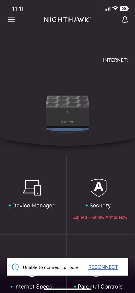

MR60 continues to disconnect from Internet
I recently moved to a new house and switched from Xfinity to ATT Fiber.  ATT router/modem is working fine and when I connect directly to that wifi I have no issues.  My MR60, however, continues to lose the connection. It will be working fine and I can access sites and then all of a sudden it stops.
Here is what is really strange.  It will be working, I will be on a teams call and then if I go to a website it may or may not work.  when it doesn't work, I can not get to any sites, yet the team meeting continues.
Here is what I have done and what happens:
1. Reset the Mesh system
2. Reset to factory settings and went through the wizard to configure it again. Checked for and installed firmware updates.
3. Mobile app continues to kick me out as not connected
Thoughts?

    • Jmthorner's avatar
      Jmthorner
      Thank you for this.  How would I go in and make this change when I can not connect via the app?
