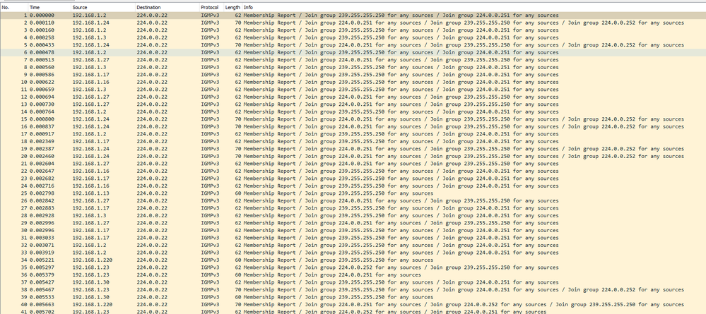

I have an MR60 router connected to the internet and 2 MS60 satelites connected with an ethernet (cat-6) backhaul.  I bought this device at Costco - strange that the model number is not listed in the model list above.

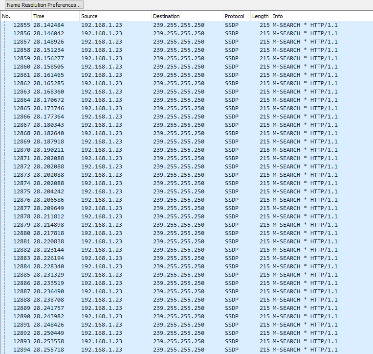

Every few days my network becomes unstable and I have traced the issue to a broadcast storm where is appears that packets are being circulated on the network continuously to the point that it is flooded and non-responsive.
Here are a few snippets from a network sniffer
I did a test and turned off one of the apparently broadcasting devices and minutes after the device was powered down, I was still seeing these packets continue to circulate.
The noise stops as soon as I turn off the MS60 satelite. It appears that this device is rebroadcasting these packets.
