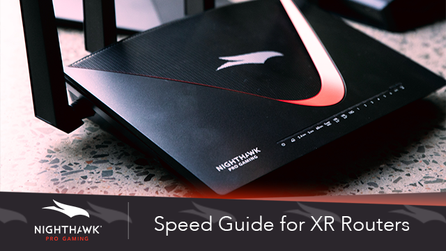

Ultimate Speed Guide for XR Routers
This guide will help you to maximize your bandwidth speeds with your Nighthawk Pro Gaming router. We recommend you only follow this guide if you believe your speeds are lower than they should be. For example, you usually get 100mbps download speed but you are getting 50mbps.
