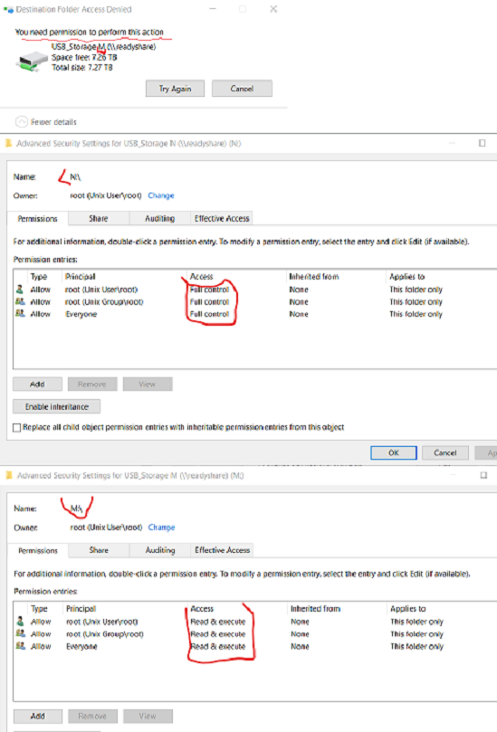

I have two hard drives connected to the router.  They have both worked perfectly in the past.  One is a Western Digital and the other is a Seagate.  They are mapped in W10 Pro to M: And N: respectively.  I can copy a file to N: but not to M:.  I believe it is a permissions problem but cannot solve it.
Here is the ERROR, permissions for N: and permissions for M: (for comparison):

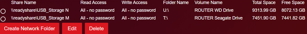

      NTFS
      8 TB
      10TB
      I've been dinkin around with it.... i deleted the problem drive from Duma and reconnected.  No fix though.  Thank you for the reply.

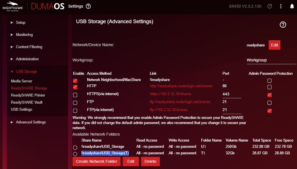

      • FURRYe38's avatar
        OK, so other that drive size differences, I was able to write to 1st 250Gb USB drive.
        Then installed a 2nd 32Gb thumb drive and also write to it.
        I use the Share Name path in Map Drive to get Explorer to access the drives:
        This is the 250Gb drive installed by itself: Port 1
        I placed data on it already prior to installing on the router to see if data would populate.
        This is the 32Gb Thumb drive installed WITH the 250Gb USB mechanical drive: Port 2
        I formatted the thumb drive for NTFS and left it empty. After installation and map drive. I dragged some files over to the explorer window from the desktop and the files copied over successfully.
        Wondering if your situation could be a drive size issue.
        Can you try two smaller USB drives as a comparison test to see if the problem continues?
