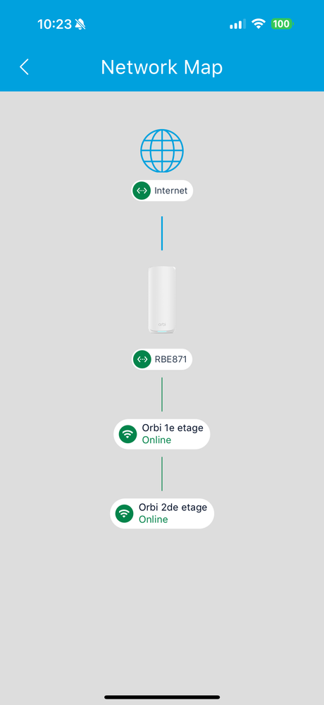

Hello,
I have a 3 story home, ground floor my RBR870 is placed and the other 2 floor both have an RBS, the network map shows how the devices are connected.
What is not logical:
RBR (ground floor) is connected to first floor iPad
RBS1 (1st floor) is connected to 2nd floor Energy socket wifi device
RBS2 (2nd floor) is connected to ground floor front door doorbell
In all of the above cases there is a Orbi device much closer and should have a much stronger signal strength. Especially the doorbell where the connecting to the ground floor RBR would be expected. If not the RBR then connecting to the 1st floor Orbi would be a so much more logical option then the 2nd floor Orbi.
Question is here, is the devices view broken in the app or is something more principal broken where devices do not connect to the strongest/closest Orbi device and therefor have slower connections?
If it is the second, that would be a serious flaw in the working of the Orbi Mesh system.

    I have a 970 and have not noticed this behavior, although I will say the device list can be wonky at times, plus it has a lag of reporting the correct info - but no more than a minute or two. But at other times, I have seen it say WiFi-connected devices are wired, and I have seen connections reported to the wrong Orbi - like you are seeing. Often times for me, a reboot fixes this.
    That said - the path of wireless signals can be deceiving. To be sure, have you tried using an app to actually see what the signal strength, in dBm, is from each Orbi device near your doorbell and socket (which I presume are stationary!)?
    If you have a Mac, I use the free app from the App store WiFi Explorer Lite - it's excellent and simple to use. You will see real time what the signals are, just walk your Mac over near the doorbell and wait a minute. If you only have Windows PCs, I am sure there are free apps that do the same thing - you need to see dBm.
    Unfortunately, using an iPad or iPhone won't work - Apple restricts that wireless data from the network to be gathered by apps, it appears.
    If the dBm measurements are close, since there is variation in the signal strength over time (you can see some fluctuation watching WiFi Explorer Lite), that when the doorbell made its decision to connect, that Orbi was the strongest device; later on, another device had a slightly stringer signal, but not strong enough to switch. If you think about it, there needs to be some number of dBm improvement required for a device to switch (5 dBm? we don't know) - otherwise, with normal fluctuations a device would be ping-ponging between devices all day.
    Now, if any of your devices are connected say at 2.4GHz to a further-away Orbi, and there is a 5GHz connection from a closer Orbi, that's much more of a concern.
    What FW version are you on? A new FW update just came out in the last 2 weeks for the 870, 10.5.17.3.

    • Within the last month, I recently installed an Orbi 970/971 network for a client (6 satellites). Beside the problems of satellites and number of attached devices being inaccurate, I too have reason to believe the "mesh roaming" is not working properly. Reason I believe this, is that I can walk to another room which is very far from the prior room and conduct a speed test (also observe the number of WiFi bars on the iPad Pro). Each time I turn the WiFi on the iPad OFF then ON, and retest, both the signal strength and speed test results are much higher - most ofter more than twice the speed! I also combined this with observing what devices were attached to each satellite to see whether the client device was in fact 'handed off'; it was not in half the cases.
      As for the nodal graph presented in the app it is unclear what exactly is displayed. I mean that there are two primary connection types PHYSICAL and LOGICAL. Certainly the physical topology can influence the graph, i.e. "daisy chaining the satellites" would result in a string of satellites as you have AND the UI being a physical representation. Alternately, if there were a Layer 2 LAN switch serving to connect all the Orbi devices rather than seeing the satellites arrange in a star-topology with the router being in the center, you still might see the 'string of satellites' because the UI is displaying a logical view AND the system has not settled on preferring the physical backhaul over the wireless backhaul.  The convergence time for the router and satellites to display as they are truly wired and operating has taken DAYS in this network. NetGear support admits this is a 'known bug' but my greatest fear is that the fix will not come in time before this customer discontinues our relationship.
      As donawalt said, there are free wifi signal strength apps available. I use a professional tool but I started out using an inexpensive android tablet with a free app - it provided me with dBm measurements.
      Given the effort and troubles I have had in the past 3 weeks with this installation, I clearly believe there are very many serious bugs in the Orbi RBE970 system. I do installs for a living with over 100 ASUS installations and recently starting to roll out Orbi. I have 4 Orbi systems installed without issues to this day but this new RBE97X series has been a total disaster.
