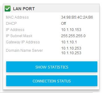

After suffering a power outage due to Hurricane Ian my AXE11000 is not connecting to the internet despite being assigned an IP address from the Comcast Business router I have it plugged into.
The AXE11000 is functioning and I can log into the management webpage. It is currently running Firmware Version
V6.0.3.85_3.1.15. I was even able to upload and re-install my saved settings from 9SEP22. This came after factory resetting the device
I currently have the AXE11000 running in AP mode. This is is the exact same set up I had prior to the power outage due to the hurricane. Nothing has changed in terms of cables or how I had the router configured prior to the power loss. However now the AXE1100 router will not connect to the internet and instead I get the constant "waiting" message on the management webpage as attached and the red light.

In router mode the RBR assigns all the connected devices IP addresses as expected, 192.168.x.x.
Comcast router/model assigns the RBR the correct IP reservation I have set up (10.1.10.153) as expected.
I added it to the DMZ within the Comcast router/modem as suggested.
Still no internet connection via the RBR.
The RBS are wired via CAT6
