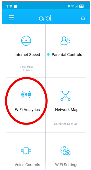

    If the backup camera and Orbi are set to 2.4G channels that are far apart, they should not interfere. The Orbi app has a feature called WiFi Analytics:
    scroll right to find;
    • A page that shows every WiFi channel found and what channels they use
    • Another page that shows how many WiFi systems are using each channel
    Once you find which channel the backup camera is using, set the Orbi to a channel at least 6 away.
