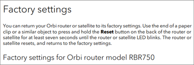

I did everything according to the manual:

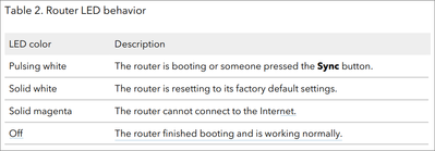

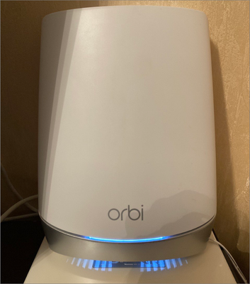

I pressed the reset button with a paper clip until the small rear power LED indicator began to blink amber. After that, the main front LED indicator began to blink white (pulsing white), which meant that the router was loading. Approximately 30-60 seconds later, the indicator began to glow white (solid white), which meant that the factory settings were being reset:
The problem is that the indicator keeps glowing white (solid white) and nothing happens. I thought that factory reset might take longer and left the router in this state overnight, but in the morning the main LED indicator was still on solid white.
I tried several more times to press the reset button and repeat the process, but the result was always the same - the router freezes at the time of the resetting to it's factory default settings. Of course, login through 192.168.1.1 is not possible anymore.

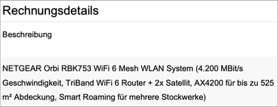

  • The correct product is Orbi RBK753.
    A screenshot from the invoice:
