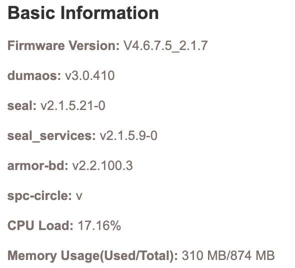

New - RBR850 / RBS850 Firmware Version v4.6.7.5 Released

I have the RBR850 and RBS850 and am having the constant disconnect issue. I would like to try this firmware but that link looks to be only a .chk Windows file. Is there a version I can use for Mac?
The .chk file is for the Orbi system, Windows or Mac doesn't matter and you don't open the .chk file. You send it to the RBS first the RBR lasty using the manual update process linked in the first post using a web browser connected to the RBS or RBRs FW update web page.
Thank you! I've installed 4.6.7.5 and power cycled my RBR850 and 2 RBS850. I've noticed one dropout in the first five minutes from 1 satellite. I'll give it some more time before doing a factory reset. Fingers crossed.

Any ideas how to investigate and resolve this (I'm out of support)?
- nexus_orbiAspirant
>> What is the size of your home? Sq Ft?
>> What is the distance between the router and 📡 satellite(s)? 30 feet or more is recommended in between RBR and RBS📡>> to begin with depending upon building materials when wirelessly connected.
>> I ran 13 days with zero issues with v5 and RBS flasing anything.
>> Manual channels 1 and 40, 40Mhz only. CTS 64, RBS wireless and wired. 50% Transmit power on the RBR.
>> Traffic Meter enabled set to no limit.
Not sure about the sq-footage, it's a rental. It's an "L" shape though, with the head of the L about 12-15m away from the heel, and the toe about 5m away from that.
All the radios are at 100%, the CTS is 64, it is 20/40 mixed. Most everything is default. I have traffic metering on, and all the logs are also on.
I've taken a debug capture of the network when the problem occurred. Maybe it would help if I sent this to someone?
There were interesting messages in a file called "critical_attach_log_tmp" at the time the satellites went down:
[deleteSatelliteDeviceInfo 5575] satellite-device 542A1BC262E0 disconnected, delete it
[deleteSatelliteDeviceInfo 5575] satellite-device C4B301DAC0E3 disconnected, delete it
[deleteSatelliteDeviceInfo 5575] satellite-device 2A622873ACC7 disconnected, delete it
[deleteSatelliteDeviceInfo 5575] satellite-device 949F3E83A868 disconnected, delete it
[deleteSatelliteDeviceInfo 5575] satellite-device 949F3E83C08A disconnected, delete it
[deleteSatelliteDeviceInfo 5575] satellite-device 949F3E63BE1A disconnected, delete it
[deleteSatelliteDeviceInfo 5575] satellite-device 949F3E435216 disconnected, delete it
[deleteSatelliteDeviceInfo 5575] satellite-device 5CAAFDF32AA4 disconnected, delete it
[deleteSatelliteDeviceInfo 5575] satellite-device F8FFC20E85F5 disconnected, delete it
[deleteSatelliteDeviceInfo 5575] satellite-device C22F97844EAC disconnected, delete it
[deleteSatelliteDeviceInfo 5575] satellite-device 2CDB0715FBB7 disconnected, delete itI'm not sure if this is related to the problem or not, but it seems odd.
The rest of the logs don't really make sense to me.
