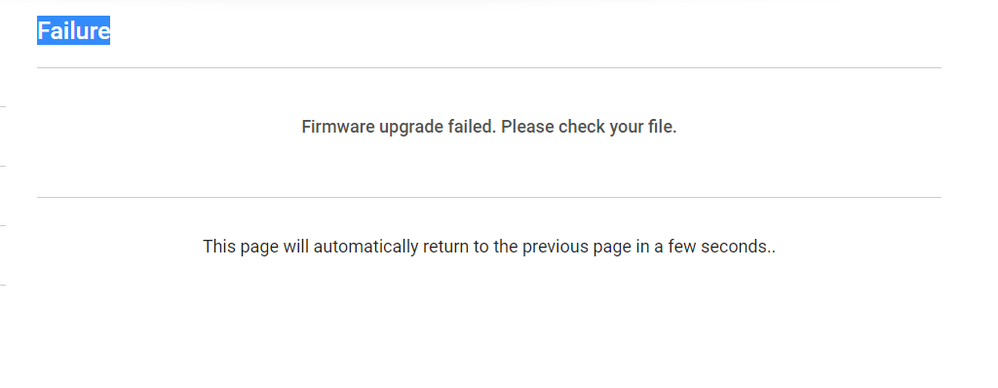

    Online update says “No New Firmware Available” for RBRE960 and for RBSE960 stats “ Service unreachable”
    Downloaded and unpacked the files. Try to manual update RBSE using RBSE960-V6.3.7.5.chk I get a message “Firmware upgrade failed. Please check your file.”
    Did try Edge, Firefox and Chrome on a fresh installed Windows 10, no antivirus or security soft installed. Wired network.
    Did anyone update successfully using the files from the link?

      Just in case it helps, I had the exact same problem with one of my two RBSE960 satellites. I also found the only option available was to manually upgrade.
      The upgrade worked fine on the first satellite (with wireless backhaul) but not on the second (with ethernet cable backhaul). I powered the problematic satellite off and on and then the upgrade worked ok. I then upgraded the router without issue.

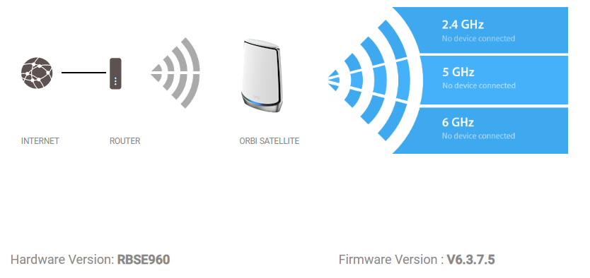

        I guess I never picked up this up before, but the RBS web page has a 8 series picture icon:

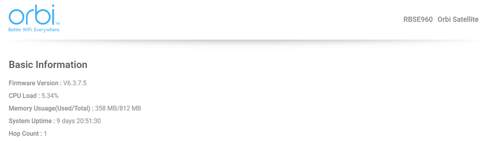

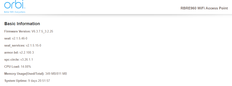

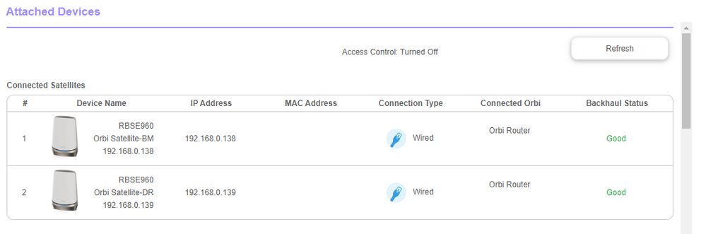

        Going on 10 days of good uptime on the 9 series in AP mode thats connected to a XR1000 router and a CAX80 modem:
        RBS are ethernet connected to the RBR using 2.5Gb ports with XS505M and GS110MX in between them.
