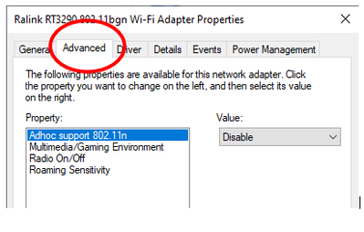

    I do not have a computer capable of WiFi6E, and thus lack the personal experience described by TC_in_Montana . Would you please consider verifying that the up to date device driver supports WiFi6E by navigating to the Control Panel, Network and Sharing Center. Select Change Device Settings (left side of screen). Then right click on the WiFi adapter, select Properties, select Configure. Then select the Advanced Tab.  Here's what my old desktop WiFi shows:
    My newer laptop has a lot more entries on the Advanced tab.  Does yours have an entry for WiFi6E?
