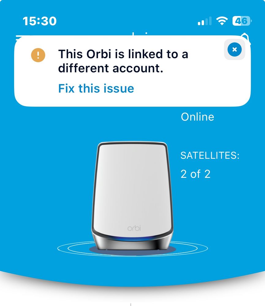

ORBI App Strange Message
I own an RBK853 ORBI system. Has been running fine for several years. Currently on V7.2.7.15_5.1.16 firmware. Had a power outage and rebooted my system yesterday. Went to use ORBI app on my iPhone this morning and got an odd message stating, "This Orbi is linked to a different account."
My RBK853 system has been registered since 2023 and currently shows up in "My Registered Products".  I get this page if I select "Fix This Issue".
 I'm not willing to do a factory reset just for ORBI app's sake. The web-based app is working fine. Any idea why this is happening? Are there any work-arounds? Thanks for your help!

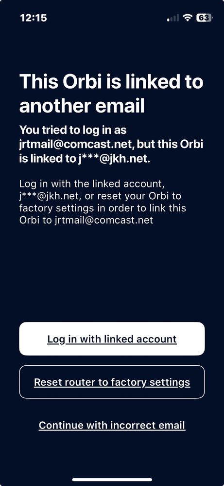

  • CrimpOn's avatar
    CrimpOn
    What happened when you selected "Continue with incorrect email"?
    • tucsontico's avatar
      tucsontico
      Virtuoso
      The app simply jumps back to the original page and displays the "This ORBI is linked a different account" warning in a pop-down window.
  • FURRYe38's avatar
    Had this system been linked to your comcast account prior or to this jkh.het account?
    You'll need to factory reset the system and setup from scratch using the Orbi app to get it connected to the comcast account if that is needed. Save off a backup configuration on the RBR first, then setup using Orbi app and get it logged in, then reload the backup from file. Might work.
    Or reach out to NG support. Not much we can do from forum with user account issues.
      tucsontico
      Virtuoso
      I purchased the system used in late 2022. Did a factory reset when I originally set it up with the Comcast.net account. Never had this warning in the prior 2 years on my Comcast account. I've rebooted the system many, many times since that initial install. Very odd this would crop up after the recent reboot.
