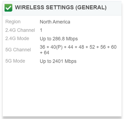

Hi everyone,
The 2.4G WiFi of my Orbi RBK762 system is operating at 286.8 Mbps. I have already turned off 20/40 MHz Coexistence and I have also tried other channels. Preamble Mode is set at Automatic and Transmit Power is at 100%. What exactly is stopping the 2.4G broadcast from reaching 600 Mbps, as advertised?

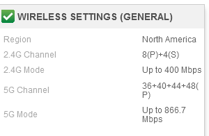

    Blanca_O KevinLiT
    • CrimpOn's avatar
      CrimpOn

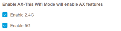

      Thanks for providing the screen shot.  It appears that this system is using only one 20MHz 2.4G channel.  Can you check whether AX is enabled or disabled on 2.4G?

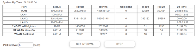

      Hi FURRY,
      Do you mean this page? It still says 286M.
      I do not have a smart device that can only connect to 2.4G but according to some of the devices located slightly further away from the router (not so far as the router sometimes assigns 5G to the device and sometimes 2.4G), I have never seen the link speed go above 200M on 2.4G.
      I am using Chrome.

        Is 40Mhz Co-existence only enabled Under Advanced Tab/Advanced Settings/Wireless Settings
