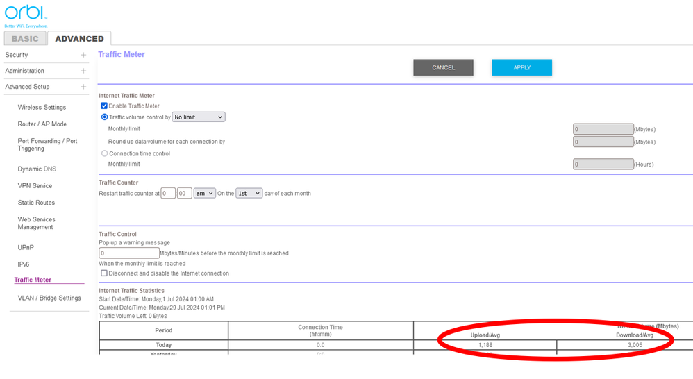

Also, I have enabled the traffic meter, I will keep an eye on that one, but one thing that I can say that I already replied to someone in my post is that connecting the ethernet cable directly to the ORBI when I'm experiencing the issue and do an speed test, it has speeds around 90/100, If I do it directly through the ISP modem, it gives me 200mb.
