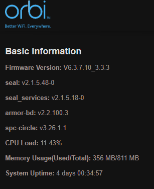

    I might haver rebooted mine 4 days ago but it's been online and working well:
