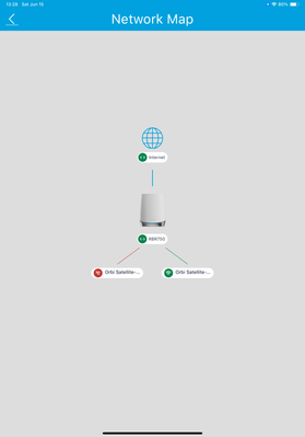

Orbi RBR750 satelite update without ethernet
I have an Orbi Mesh system RBR750 with two satellites. In the orbi app the are red in the device manager.  There RBR750's firmware is current but the two satellites have dashes where the firmware version should be. (I assume RBS- means satellite).
How do you update the satellites without ethernet?
I had this similar issue over a year ago with no resolution.

    Are they appearing in the RBRs web page as connected or disconnected?
    IF they can be ethernet connected, connected them that way and use the IP address seen on the RBRs web page for each RBS and log into the RBS web page and update FW there manually:
    https://community.netgear.com/t5/Orbi-WIFI-6-AX-AND-Wi-Fi-6E-AXE/Procedure-for-Factory-reset-of-RBS850/m-p/2359585/highlight/true#M53030
    Remember, the RBS need to be updated first before the RBR, then RBR lastly.

      I think I need to update the satelites but do know how. I have the app but it doesn't follow the instructions in the manual: there is NO ADVANCED button or section.
      How do I do this? I have an Imac, MBP and a windows box downstairs.
