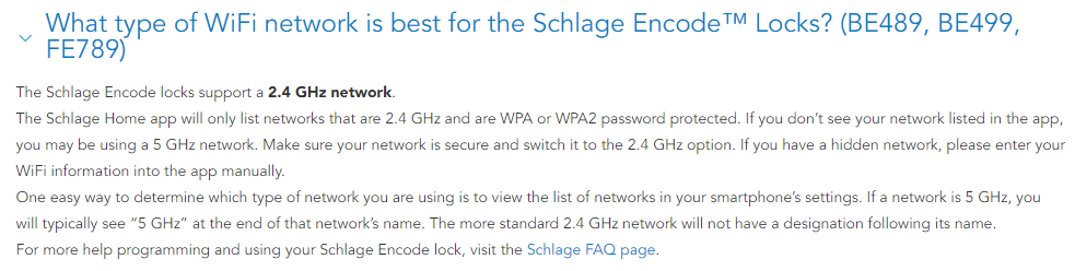

      Model # BE489WB (https://www.schlage.com/en/home/products/BE489WBCAMFFF.html#)
      From what I've researched too, it should only pickup the 2.4G channel too just like you said. I'd say the lock is roughly 5-8 feet from our modem and router. We have Spectrum as our internet provider and use their modem. The other lock is roughly 5-8 feet from one of the Orbi Satellites.

        Took a while, but it is confirmed:
