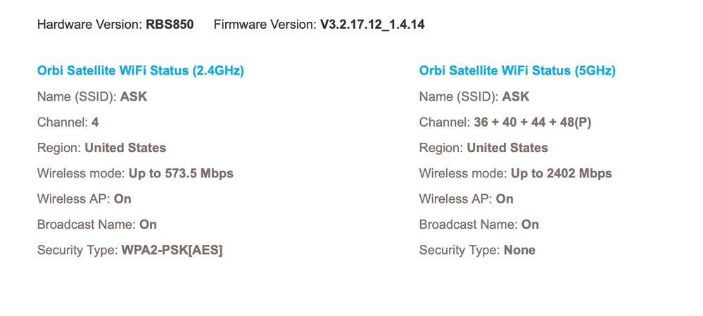

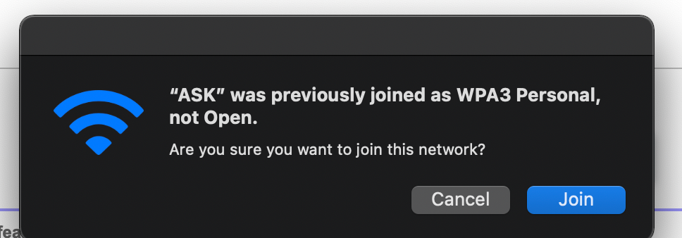

I have found that my wifi satellite is not secure on the satellite only on 5 ghz. I have tried to reset but when I do it creates a new wifi SID for my 2.4 on my satellite. You can see my mac connecting to this device and stating that it is not secure. I see in 2019 someone had this issue and fixed it with telnet. This is no longer an option so i'm not 100% clear what my next steps are.

  • What Firmware version is currently loaded on the RBR ane RBS?
    This would be a problem only solved by using same version of FW on the RBS as whats on the RBR or a reset of the RBS to the RBR.

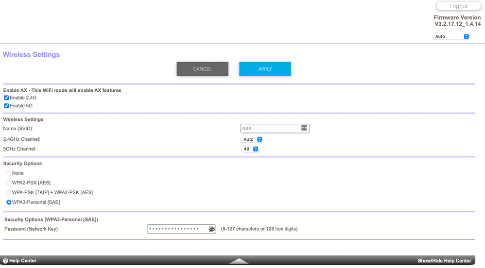

  • I have the same problem for my rbk852. The only way to solve this quick is to change the 2.4g and 5g channel and wait for the reboot. Then you can change the channel back. (BTW, i also use the ap mode)
