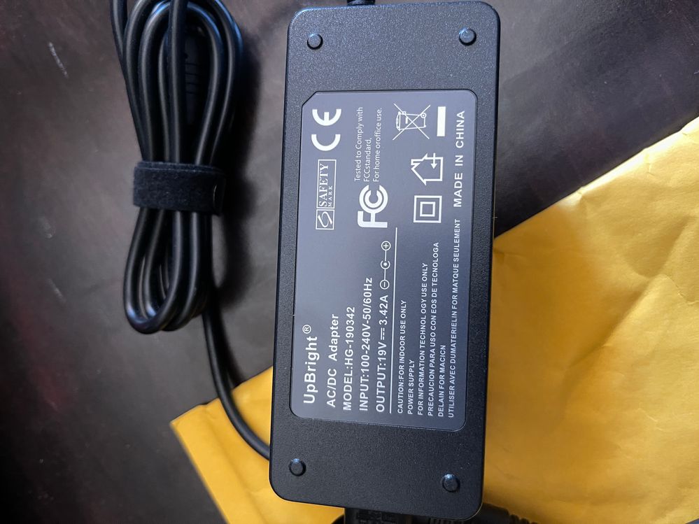

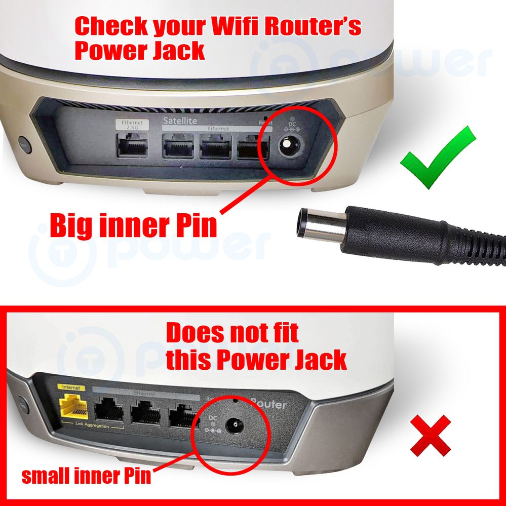

The first two power adapters I got were the right voltage and amps (3.16A 19V) but the barrel to plug into the router or satellite is too small. Thank you for any help.

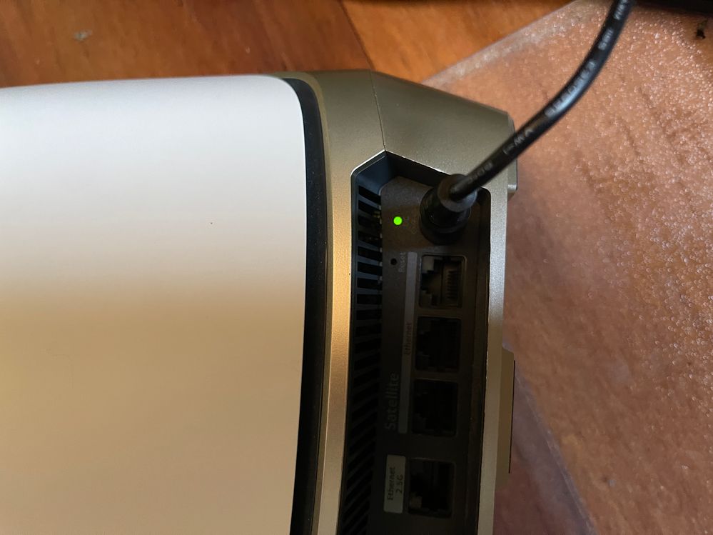

Ok, Good news, this particular PS arrived to day and has correct sized plug that works for the 960 series:
https://www.amazon.com/Kircuit-Compatible-332-11588-01-3321158801-PY321200536/dp/B0CH3FW3HS
I was only able to connect and power ON for a short while. I'll be sending this back.
Hopefully this is a good alternative for users that may need one if the stock PS goes back or gets lost or damaged.

- I received the power adapter from Amazon today and ONCE again it was wrong. The center barel size on my routers are big and all the power adapters that I have received have been too small. I took a picture of the latest one that I just got today next to the plug hole. The issue I have had are none of the barely sizes are the large center post. The previous 800 series routers and the nighthawk routers used the smaller center barely like I have received I think but they changed it for the 900 series. (From what I have found out the hard way)

AC adapter for Netgear Orbi 960 970 RBKE96 , RAXE500 / RAX200 wifi-7 router, here is the best one I found.
https://www.amazon.com/dp/B00IFWXZDE
