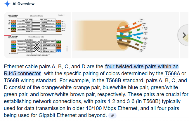

    For T-568B, the "D" pair is the brown wire and brown/white wire.  (pins 7 & 8 on the RJ45 jack).
    With two Ethernet cables showing the same behavior, the RBR750 appears to be busted.  The warranty was one year and it appears to have lasted three years.
  • FURRYe38's avatar
    What is Pair D? Not sure if thats a valid term or description. Never heard that said before.

    Ethernet speed negotiation is built into the Ethernet hardware.  There is no software feature on the RBR750 to manage any of the Ethernet pairs.
