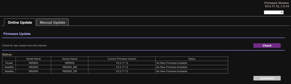

    I didn't want to create a new thread on this since my issue is very similar, but slightly different.
    I just went to do a firmware update and I see the table below.  Is it odd that there would be a firmware update available for the router but that the satellites can't reach the service for their updates?  Or, would doing the update for the RBR the propogate updates to the satellites?
    Also, seems strange that the Model Name is blank for one of my two satellites, but what do I know? lol
    Status:
      Model Name Device Name Current Firmware Version Status
    RouterRBR850RBR850V3.2.16.22V3.2.18.1-signed
    Satellite Satellite-2V3.2.16.22Service unreachable
    SatelliteRBS850Satellite-1V3.2.16.22Service unreachable
    • FURRYe38's avatar
      The RBS should be updated first. Probably since the FW is not in sync with the RBR, maybe a reason why the RBR is reporting this.
      Manually download the FW for v18.1 for the RBS and apply it to the RBS using the RBS web pageL
      https://community.netgear.com/t5/Orbi-AX/New-Firmware-Version-3-2-18-1-for-RBR840-850-RBS840-850-Released/m-p/2084211/highlight/true#M14344
