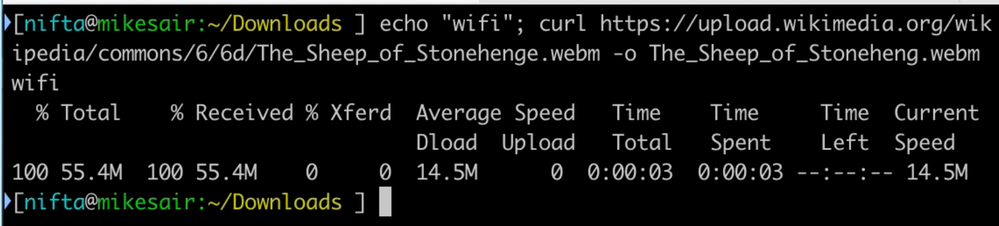

here's what i get when i try to download a 55.4mb file over wifi.. everything is fine:

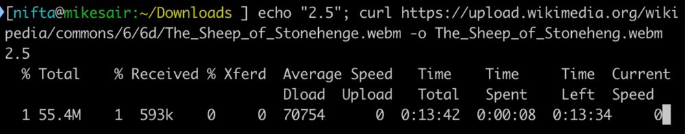

and this is what i get when i try ethernet (this one is connected to the 2.5 port, but it's exactly the same behaviour with the other 3 ports.. no other device is connected via ethernet).. it starts ok:
then speed drops to 0 after a few seconds:
and stays like that.. i grabbed this screenshot after a minute, but trust me, the avg dload speed just keeps dropping, time left keeps climbing and current speed goes on at zero:
this issue caused all my synology hyper backups to fail for a month or two until i figured it out, so i guess it occurs with sending data too.
