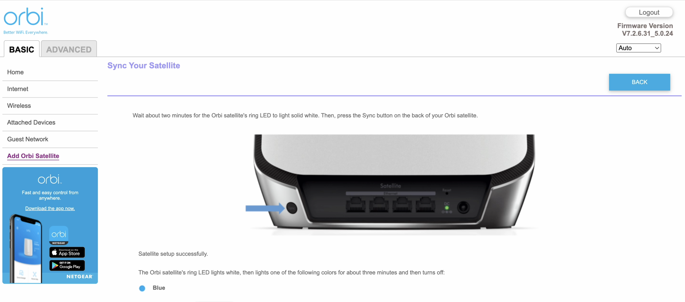

I've been trying to sync my RBS860 to my RBR860 and the setup up the satellite fails each time. I've tried through both the app and the web browser of the router (192.168.1.1)
When trying to set up on the app, the message ultimately received is 'Satellite not found'
When trying to set up on the web browser, it mentions 'Satellite setup failed.'
I am sure I am pressing the sync button on the RBS860;
When trying to set up on the app, I pressed the sync button on both the router and satellite.
When trying to set up on the web browser, I pressed the sync button on the satellite and pressed sync in the web page.
The IP address assigned to the router was 192.168.1.55; I was able to access this only one time via web browser where I was able to confirm the firmware is the same as my RBR860.
However, I've never been able to get the RBS860 to appear in my attached devices list. It only appeared when connecting an ethernet cable between the two. I've also tried factory resetting the satellite a few times as well to no avail.

      I didn't see the picture. If v.31 is the case, something to consider is downgrading FW on the RBS then RBR lastly to v.21. Been lots of posts with users having issues with v.31 FW. v.21 is most stable.
    • thebiggest's avatar
      thebiggest
      When using the Generation new backhaul password button you mentioned, it mentioned 'Satellite setup successful' when adding the satellite via the web page via the Basic Tab -> Add Orbi Satellite
      The led indicator on the satellite flashed blue and turned solid blue and is now off. However, the Satellite itself is still not listed within the Attached Devices -> Connected Satellites.
      When accessing the Advanced Tab -> Security -> Access Control, the RBS is only listed under the 'View list of allowed devices not currently connected to the network', which I assume is because I connected the two previously via ethernet.
      Will there be any issue with me downgrading the RBR to v.21 via the web browser, if the RBS is currently on v.31?

    Hello thebiggest ,
    I understand that you are having issues connecting your Orbi satellite to your Orbi router. From the attached photo your RBS860 is on the latest released firmware version 7.2.6.31.
    Please follow the instructions below to resolve this issue:
