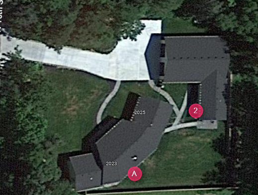

      What is the size of your home? Sq Ft? ~2000 sq ft but two buildings. "A" is the approx location of the primary AP and "2" of the satellite in my home office. This is approximately ~50 ft and is about as close as I can possibly get short of running cables across the floor of my main home. Both APs are along outer walls of the buildings and "2" next to a window on top of the fridge there.
