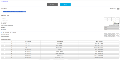

Hi,
I have the same issue...
Firmware up to date (V7.2.6.21_5.0.20)
When trying to "apply" changes, get a "400 Bad Request"
When selecting, then deselecting the "Support Automatic Private IP Addressing (APIPA)" , then "Apply" works...
But the rules are not taken into account...
LAN setup :
Results after multiple reboot :
    Could you please humor an Old Guy and make a screen shot of the Help information that pops up from the bottom of the screen when the arrow is selected?  I understand what APIPA is, but am totally confused about the meaning of "Support..."

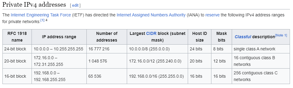

    These automatic IP addresses are in a totally different IP subnet from the normal private IP address spaces:
    I have two different Orbi routers, and neither has this option on the LAN Setup page.  Nor can I find any mention of this option in the RBR850 User Manual.  Sort of hoping that there is information in the Help screen that may explain what this option accomplishes.
    There was a post on the forum back in 2022 asking about this, but no answer.
    https://community.netgear.com/t5/Orbi-WIFI-6-AX-AND-Wi-Fi-6E-AXE/APIPA/td-p/2257586
    There is a Knowledge Base article saying that firmware v4.6.9.11 adds support for APIPA:
    https://kb.netgear.com/000065128/RBR840-RBS840-Firmware-Version-4-6-9-11
    Thanks
    p.s. If this is obvious and I am just "dumber than dirt", somebody please point me in the right direction.

      The user should be able to use any of the 3 IP class referenced as they are mentioned for home IP configurations.

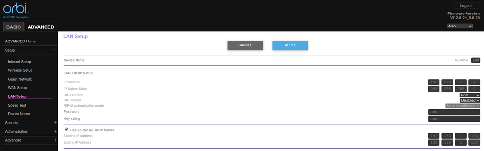

    Reading through the messages again, I am struck by this in the first message.  I have firmware v7.2.6.21 on my RBR750 and the APIPA option does not appear.  Does this version of firmware have different options for the 850 product than for the 750 product?
    • FURRYe38's avatar
      There both the same in features in the FW UI.
      • CrimpOn's avatar
        CrimpOn
        I went off on this tangent after observing the screen shot showing "Support APIPA" (the first post) and could not find the option on my 750 firmware v7.2.6.21_5.0.20
        Very confused.
