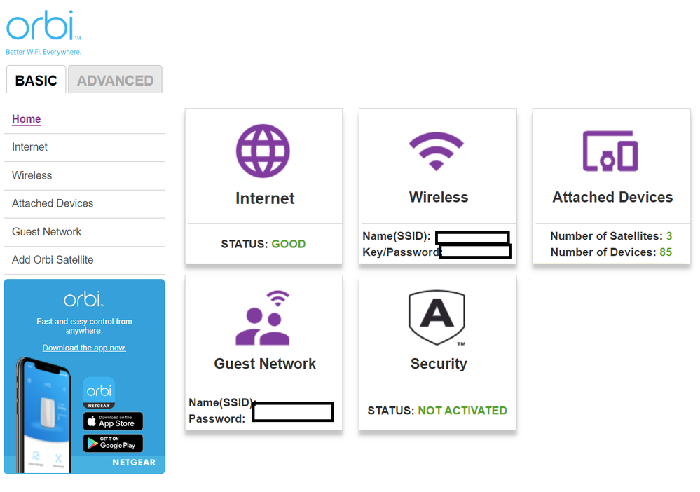

I do have a problem with my RBR850. Since a few days it is constantly dropping WiFi: on the router everything is OK - no issues but no device can connect getting stuck at "getting IP address". Only reboot helps for a few hours.
RBR850 has 4 satellites.

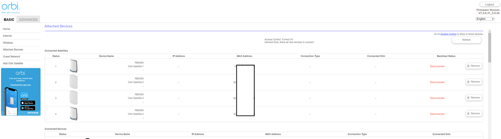

Attached screenshots shows the architecture (of course screen illustrates satellites as disconnected since I just rebooted the router and they need up to a few hours to get connected back - this is also very annoying). Usually there is about 100 devices connected to this WiFi. Guest network is also up and running (quite often it is not possible to connect to the guest network). VPN not activated on the router  - used only by connected by LAN PCs. Activated IoT network but not used yet.

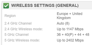

      What channel configurations are currently set on the router?
      2.4GHz Auto 8
      5 GHz 36 + 40 (P) + 44 + 48

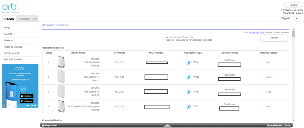

        ==> RBR and RBSs are connected via LAN. The distances between them are about/up to 100ft. It is not a problem with WiFi coverage.
        How are the RBS ethernet connected to the RBR? Directly behind the RBR or is there any LAN switch or LAN Patch panel in between them?
        What CAT# lan cable is used to connect the RBS to the RBR? CAT6 UTP is recommended here.
        2.4GHz Auto 8
        Try channel 1 or 11 on 2.4Ghz. Try 48 on 5ghz.
