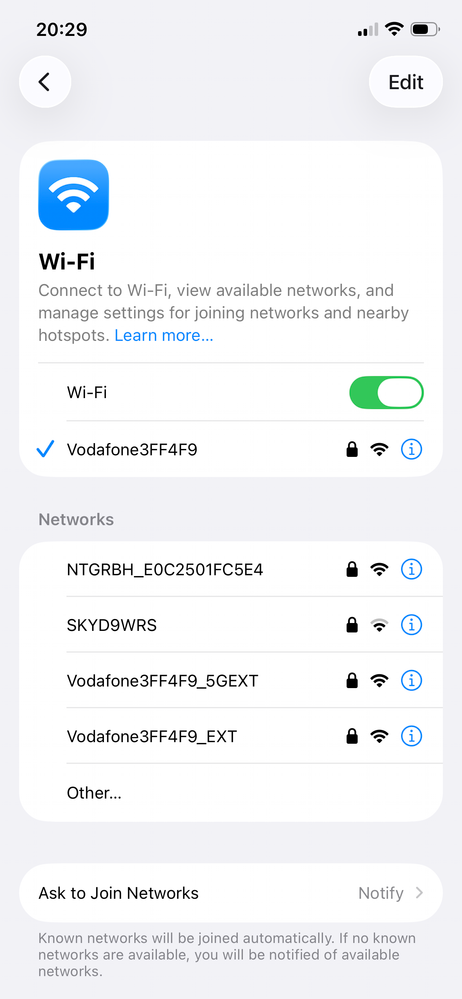

This is what my iPhone is showing ; it’s connected correctly
sky is a neighbour
the netgear is the router default I didn’t set up
the 2 not connected Vodafone’s are the old ones with no infrastructure remaining. I’ve told my phone to forget both
my computer connects to Vodafone xxxxxx_ext and won’t work connected to the correct one

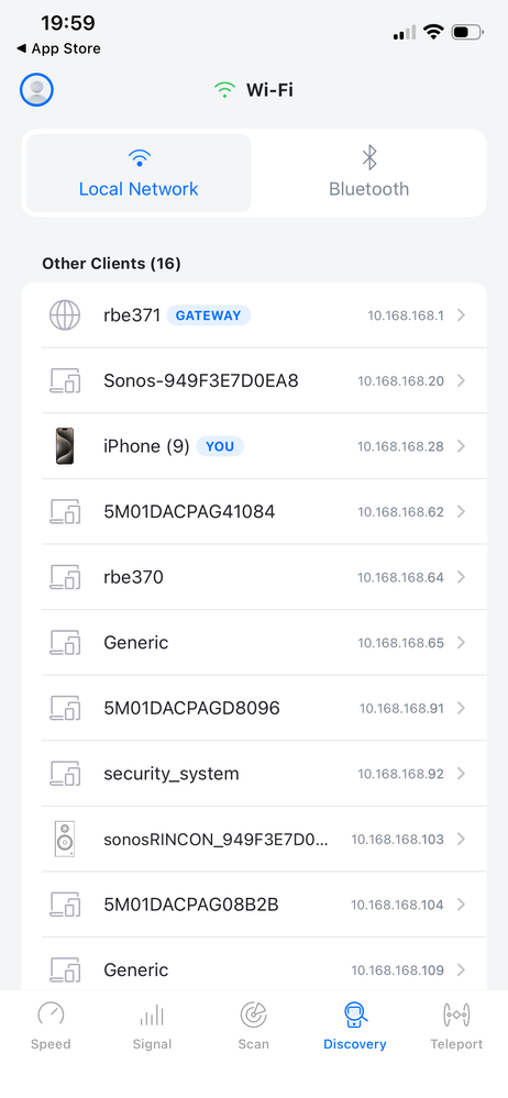

WiFiman gives me this if that helps ?
I have Ubiquiti WiFiMan installed on an Android phone. Rather than "Discovery", I selected "Scan" which provides a list of WiFi access points, and shows the MAC address of each.

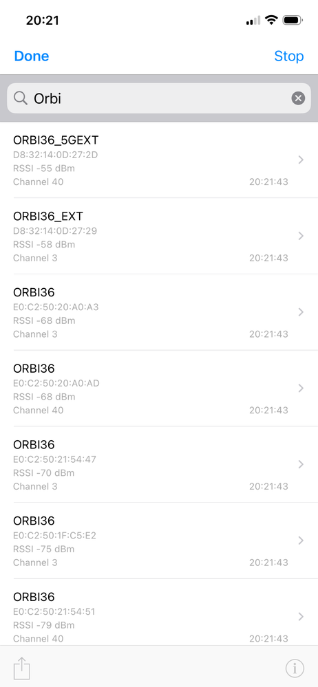

- ggb1979Aspirant
Hi this is what WiFi scanner shows
the MAC address for _ext and _5gext are the same but don’t match any of the orbi macs
they also don’t match the macs of anything else on my network

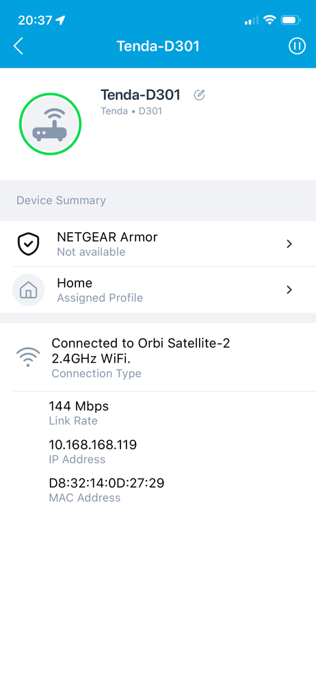

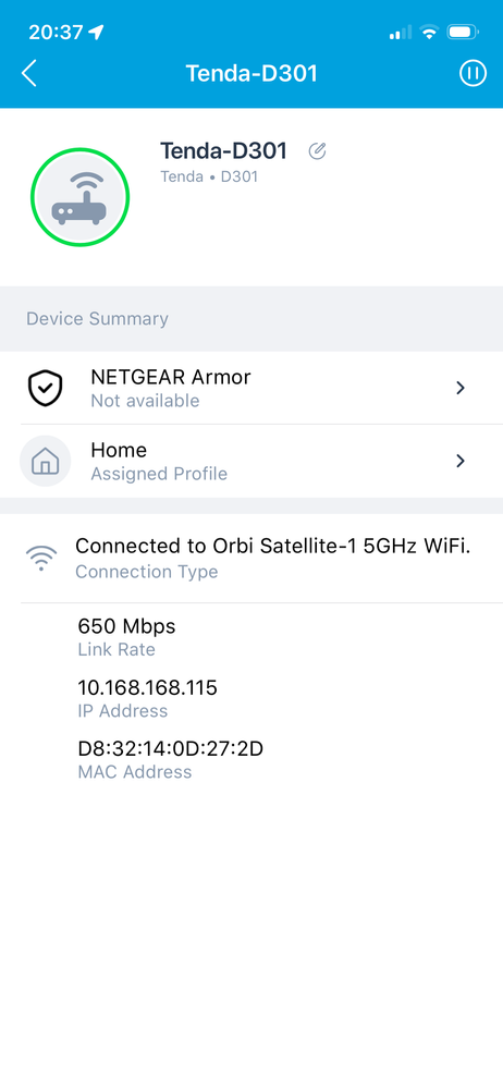

- ggb1979Aspirant
Tell a lie using device manager on the Orbi app I’ve found 2x tenda devices each with the matching mac code
these are not separate physical devices I promise there is nothing physical in my house I am not aware of
these are somehow integral in the satellites
