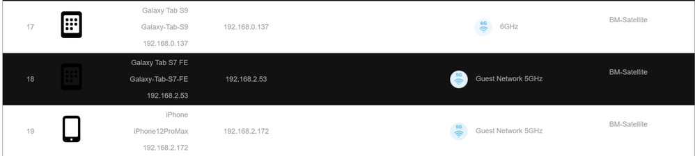

        I activated GN on my 970 series and devices are connecting at the RBS:
