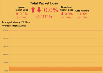

I did a power-cycle after disabling IPv6, and no flips to 5G cellular in 2 days. Memory creep can take up to 2-3 weeks to show up, but if I go 2 weeks with no flips to cellular/loss of WiFi in the house I would say they nailed it. This FW is solid otherwise for me - streaming, speed, latency, packet loss all perfect. Here is a mid-afternoon workday zoom call latency/pkt loss tracking result:
Looking good. Fingers crossed.
