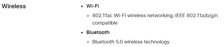

  • CrimpOn's avatar
    CrimpOn
    MacBook Pro 2018 specs can be found here:
    https://support.apple.com/en-us/111949
    5GHz WiFi 802.11ac (WiFi5) is capable of 400+ Mbps speed.  WiFi speed varies dramatically with distance between WiFi access point and mobile device.  When you eventually upgrade to a newer MacBook, the speed will increase dramatically.
