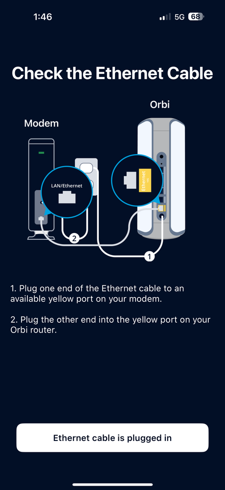

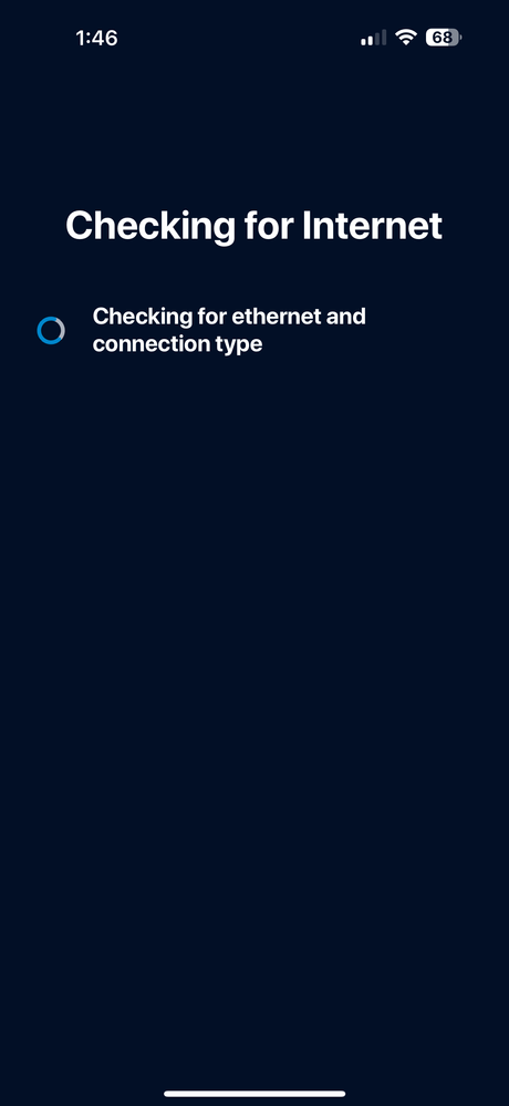

Running 970/971, latest firmware. Arris S34 cable modem. Purchased unit new last May, no issues until now. Sudden loss of internet with a solid magenta light. Checked modem, ISP, etc., to no avail. Performed factory reset a few times but could not ever get unit to pick up internet. Fails the “Checking for Ethernet and connection type” step every time. Swapped in a test 970 and everything works perfectly, so I don’t think it’s modem issue. What else can I try?

      I don’t think it’s the LAN cable as I said I am currently running another 970 with all the same equipment, cables and all. Works fine. Just can’t seem to get the other unit to connect to internet.

    I understand that you are having issues with your syncing all the devices of your Orbi Mesh system. You also note that you use different a different 970 and it worked. The Orbi mesh system includes one router and multiple satellites based on the configuration ordered. If you ordered a kit this means you are replacing the router (RBE971), with your satellite (RBE970). Please ensure that you are connecting the router (RBE971) to your modem. The satellite (RBE970) can only be connected to the router. Connecting the satellite (RBE970) to the ISP modem will result in no internet access.
