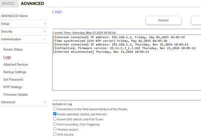

      My network topology is :
      • Router : Orange France Livebox 7
      • Orbi 971R is configured in AP mode with Static LAN IP : 192.168.1.2 provided by the router Orange France Livebox
      • ORbi 971R is connected to router Orange with CAT6 or 7 cable.
      • 1x Orbi 970S  with wireless backhaul and has static IP 192.168.1.3
      • FW of both Orbi 971R and 970S is the lates PRD releas 9.12.5.3
      • The LAN topology is +/- 40 devices with +/- 10 on 2.4 GHz, +/-25 on 5 GHz and on 3-4 on 6 GHz .(i.e. iPhone 15 Pro Max + 2-3 PCs)
      • Guest Network Enabled or Disabled : Both cases tested and random reboots occurs on both
      • IoT network is disabled
      • Home is around 90 m2 with 1 R and1 satellite. The distance between R + S is around 10 - 12 m with 1 wall.
      • IP randomizers of ALL connected devices are disabled.
      When the Orbi RBE971 randomly restarts it is blinking white 3-4 minutes. And the unique satellite 970S is  pink as it lost the connection with 971R.
      When RBE971R is up again, the satellite takes +/-5 more minutes to became blue (from pink) and initially it is connected with 2.4Ghz  wireless backhaul. After +/- 10 more minutes it reconnects to the 971R with 5GHz and 6 GHz backhaul.
      Everything works fine until next random reboots.
      NG Support already requested to switch the power adapters between Router and Satellite, change the power source on the wall and reset/reconfigure the router. Non of those actions did resolve the problem.
      Today they called again following to this topic and they requested to capture logs.

      • Saner's avatar
        Saner
        Apprentice
        Is the static IP address Set on the RBR for AP mode?  What is the IP address subnet used on the Livebox 7? Does it use 192.168.1.1? And what is the Default IP address pool size of the Livebox 7? 192.168.1.2 thru .254?
        ==>  Static IP is configured only in the Orange Livebox's DHCP config.
        MAC of RBR  leased to 192.168.1.2 and MAC of RBS leased to 192.168.1.3
        DHCP pool of router Livebox is from  192.168.1.2 to 192.168.1.253
        How is the RBS ethernet connected to the RBR? Directly behind the RBR or is there a LAN switch in between?
        ==> RBS is not ethernet/cable connected. It is wireless backhaul between RBR and RBS. There is NOT any LAN switch at home. Orange LiveBox has 5 LAN port  where only 1 is 10 GBit. This port connected to RBR. All devices at home are through WiFi. Ethermnet ports of Livebox + RBR + RBS are NOT used.
        Does this still happen with the RBS turned OFF?
        ==> Never tried with RBR only mode. I need to use RBS to connect PCs at my home office room which is in the same room with RBS. Without RBS, the WiFi coverage is very low./quite unusable.
        Below the basic logs, mostly disabled
