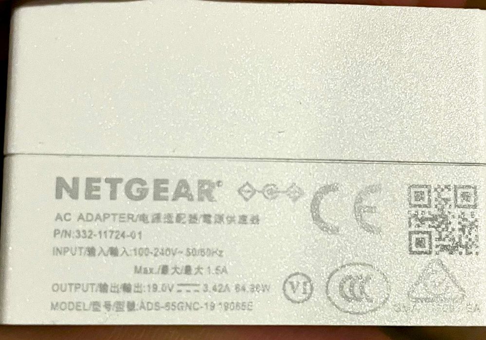

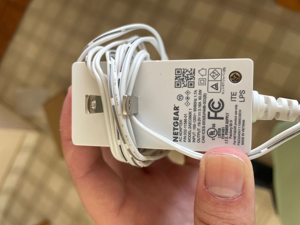

      My original RBE973 was RMA’d and to confirm, yes, the power supplies were majorly redesigned.
      Old:
      New:
      I’ll have to disconnect one of those in order to get the details on that.

      Here’s a photo of the new:
      The white with the very light grey makes it hard to capture the details. If that isn’t clear enough for you to decipher, I can type out the specs.
      • FURRYe38's avatar
        Looks like 3.42Amps and 64watts on new power brick vs 3.16Amps and 60watts
